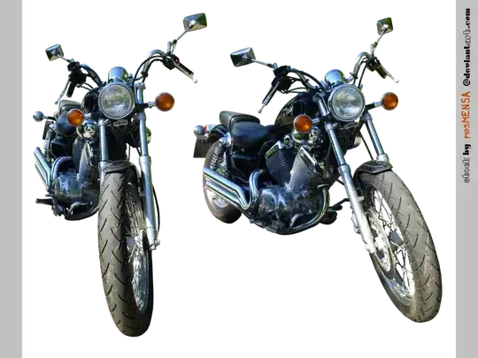

I currently ride a Honda Africa Twin and my wife rides a stock Virago 535, just like this:
