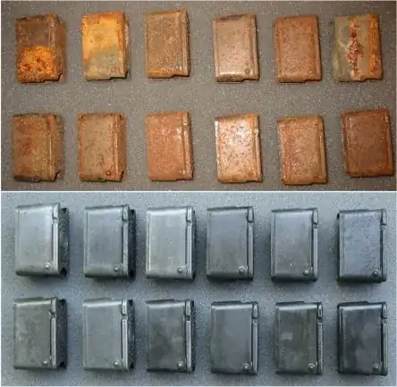

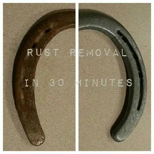

White vinegar does wonders. Fill it up to the brim, add some change. Let it sit for days, preferably a week. As you drain the tank, shake it rigorously, the flakes will come off. If you need to do this again, you most certainly can.
Vinegar is a cost effective way to do this. Here are some results of what vinegar can do for you and all your rust removing needs!
