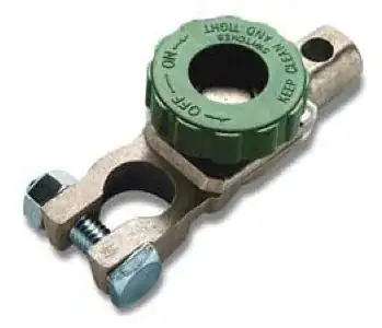

The absolute best way to check it is to use a battery disconnect. Install this between the negative terminal and the negative battery post. Drive the car for a day or two. In the morning before going somewhere connect the meter across the green nob. Make sure that the leads are well connected and don't fall off. Now twist the green nob to disconnect the battery and read the current consumption.
