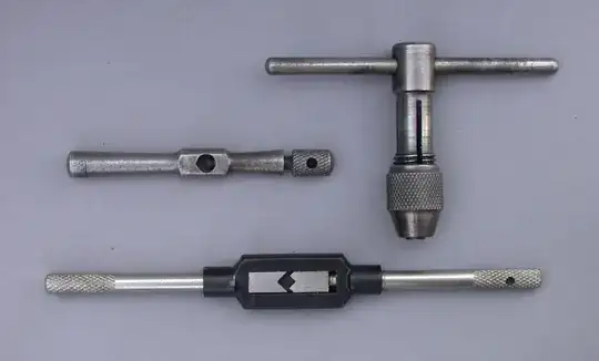

Tap Wrench
Tap Wrench

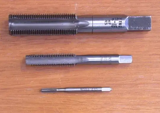

Taps
Taps

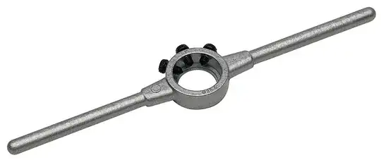

Die Stock
Die Stock

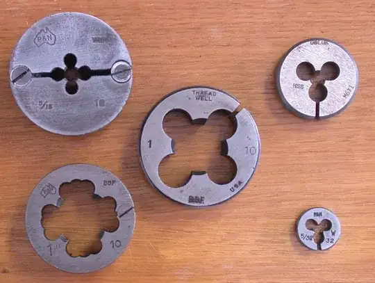

Dies
Dies

Dies are generally no problem, provided you start with a rod of the correct diameter. A high quality die will be split on one side. With the correct die stock, that enables you to spread the die open for an initial cut (hold it using the centre screw in Zaid's image), then start again but close it more for a final cut (hold it using the other two screws in Zaid's image.)

A good set of taps will contain three taps of the same thread diameter/pitch. The first will be strongly tapered, enabling an easy first cut. The last will have a square end for bottoming out blind holes. The second will be intermediate between these two in form. If you only intend to make through holes, you can get away with the first one. On the other hand, trying to start a thread with the last one is impossible.

Make sure you keep the tap straight as you start the cut. Tap wrenches are symmetrical to help you avoid applying sideways force on the tap. When using a small tap, try to obtain and use a correspondingly small wrench (a 3mm tap with a wrench designed for 12mm is a pretty clumsy combination.)

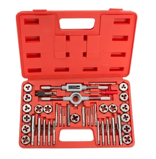

A tap and die set are tools used to cut (ie: create) threads in metal as well as cleaning up already exiting threads. A typical tap and die set will look something like this:
The set will come in SAE or Metric, covering both fine and coarse thread pitches. There are three basic items to be found in the set. The tap (long straight pieces) which are used to cut threads on the inside of metal, like in making a bolt hole. The die (round pieces) are used to cut threads on the outside of metal, like for creating threads on bar stock. The two two long pieces at the top of the set are the handles which allows you to use the tap (top) and die (bottom).
