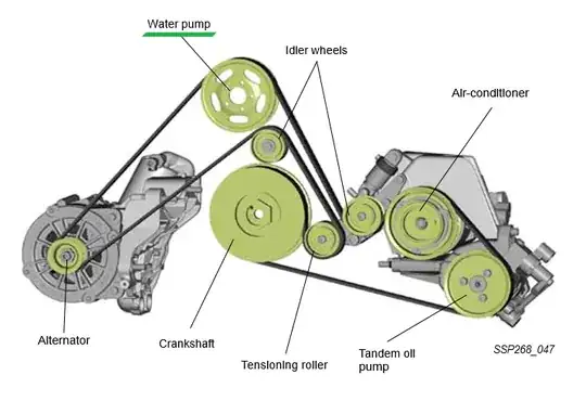

The W12 engine produced by VW utilizes both mechanical and electric water pumps (underlined with green). According to VW's documentation:
The cooling system of the Audi A8 with W12 engine is made up of the following components:
  • Water pump in cylinder block/crankcase driven mechanically by Poly-V belt
  • Map-controlled electrically operated continued coolant circulation pump -V51 as back-up for mechanical water pump and for continued coolant circulation

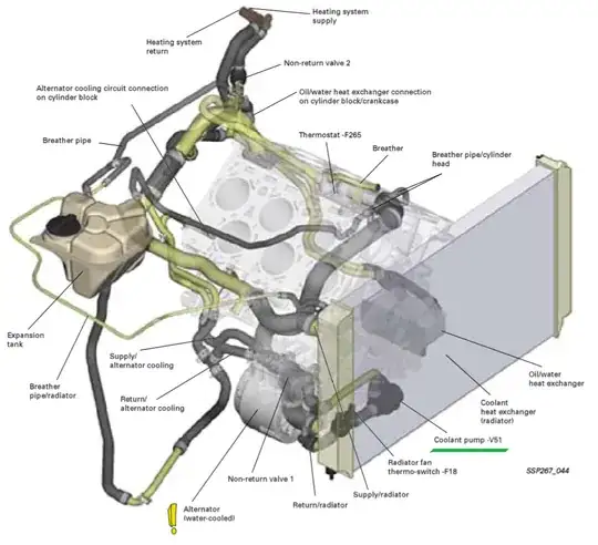

There are more details provided on the electric pump:
The electrically driven continued coolant circulation pump -V51 is located in parallel in the large cooling circuit in the return from the radiator. The continued coolant circulation pump -V51 has two functions:
  1. To provide back-up for the mechanically driven coolant pump at low engine speeds and to ensure adequate coolant circulation. -V51 is actuated via the additional coolant pump relay -J496 by engine control unit 1 -J623. Map control is employed to switch in the continued coolant circulation pump -V51 as required. The parameters used for this are the engine speed and the coolant temperature supplied by the coolant-temperature sender -G62.
    Switching levels:
    Cut-in: < 840 rpm and > 108 °C Cut-out: > 3000 rpm or < 106 °C
  2. To circulate the coolant during continued coolant circulation
Continued coolant circulation is described as well:
Continued coolant circulation is regulated by engine control unit 1 -J623 in line with a map.
Both the activation condition and the continued coolant circulation time are determined from the following parameters on the basis of an arithmetic model:
  • Coolant temperature (from coolant temperature sender -G62)
  • Engine oil temperature (from oil temperature sender -G8)
  • Ambient temperature (from intake-air temperature sender -G42)
The activation condition and continued coolant circulation period are constantly calculated from the time of starting the engine.
For continued coolant circulation, the pump -V51 and radiator fan -V7 are actuated in parallel.
The maximum continued coolant circulation time is limited to 10 minutes.
The map-controlled engine cooling thermostat -F265 is fully actuated during continued coolant circulation.
Examples of activation condition as a function of ambient and coolant temperature:
  • Ambient temperature 10 °C, Coolant temperature 110 °C
  • Ambient temperature -10 °C, Coolant temperature 115 °C
  • Ambient temperature 40 °C, Coolant temperature 102 °C
W12 Belt Drive
W12 Cooling System
