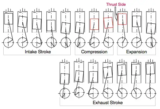

Mechanical noise is created primarily by piston slap where the piston rocks back and forth upon the wrist pin in the bore of the cylinder making a tapping noise that transfers through the solid case and emanates from the surface.

In short, the distinctiveness of your typical diesel sound comes from a combination of it's properties of low RPMs and the high compression ignition system. The actual sounds are generated at combustion and the opening and closing of valves. You really cannot hear the injection of the fluids into the chambers. Also, as another poster first pointed out (DucatiKiller), there is sometimes a piston slap that make a audible sound but not always in newer engines.
Piston SlapPiston Slap2
