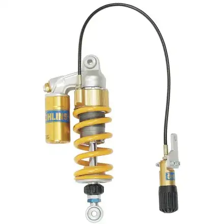

You should have a very beautiful and nicely printed booklet providing instructions for the various settings, spring selection, maintenance and installation. It would look something like this.
Depending on the model of shock, you indicated you have a nitrogen shock, the location of the setting dials are on the top, the piggyback or the remote bladder on the end of the steel braided line. See page 7 of the PDF.
  • Compression Dampening - At the top of the shock, the piggyback or remote unit. High speed compression dampening is always adjusted by the nut with a 12mm wrench or the dial on the higher end models. The screw in the middle of the dial or the nut is always for low speed dampening. Turning the screw or nut clockwise always increases the dampening and counter-clockwise always decreases the level of dampening.
  • Rebound Dampening - This is at the bottom of the shock and should be a dial or a nut. It's wrapped around the piston shaft which moves in and out of the shock body. It's mounted on the shock body.
  • Shock Length - This can be at the top or bottom of the shock depending on the model. You will see the lock nut pair on the shaft to adjust length. In the image below it has a blue anodized nut.
  • Spring Pre-load - Adjusted with the very nice spanner wrench that should have come with the shock. Decreasing spring length increases pre-load and stiffness.

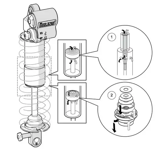

Oil Flow Diagram
Here's a reference for you to get an idea of what you are dealing with regarding oil flow. If you understand the oil flow then you can begin to understand what you are actually adjusting, which is essentially a needle inside a shim stack. Think Needle Jet/Jet Needle, right?
