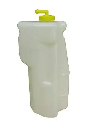

I have a 2001 Honda Prelude SH. I am looking at the coolant reserve tank. There are no min / max fill lines visible, although the manual says there should be.
I am just re-adding coolant after fixing a leak.
Is there a rule of thumb for rough min / max levels in the reserve tank if there aren't any clear markings? Or does anybody know what it should be specifically for this car?
I can't really remove the tank easily to look for markings, and I didn't see anything in pictures of the tanks on the internet.

Here is a picture of your coolant recovery tank:
If you look on the right side of it, you'll see the two lines there on the outside. Those are your min/max lines. Hopefully you can align this with what is in your vehicle to get a good understanding of where it should be.
