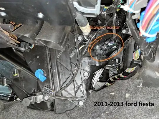

here is a clear picture underthe dash of a right hand drive fiesta. it may be the same for older fiestas but this one is a 2011
blower resistor location
It's on the drivers side, just above the pedals, a nightmare to get at. Get a telescopic mirror with lights. This helps big time. I didn't remove any panelling. Lay the drivers seat all the way back lie upside down with your head in the footwell, it can be done. Once I remembered I had the telescopic mirror it only took about 15 mins. This is for a Ford Fiesta mk6 2007 UK version.
