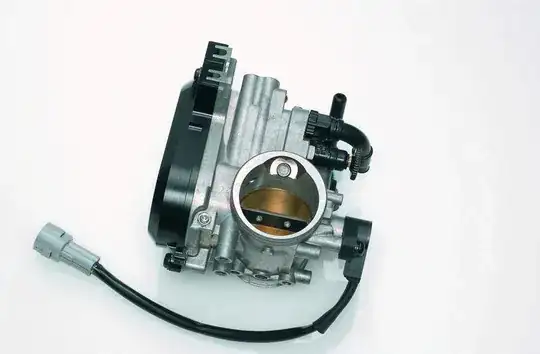

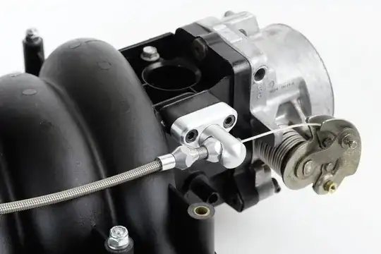

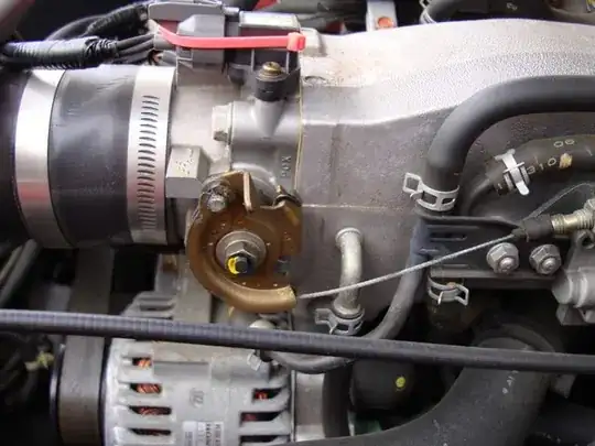

Drive-By-Wire : Look at your throttle body
If it has a throttle plate actuated by cable, you have drive-by-cable, not drive-by-wire
Drive-by-cable examples:
Honda S2000
LS1 Throttle Body

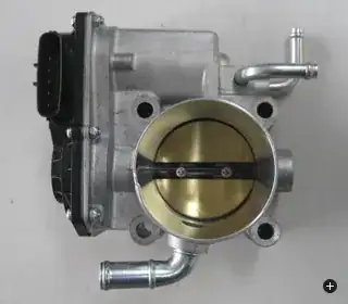

Drive-by-wire examples:
Notice the absence of a spring-loaded cable-actuator
Suzuki Swift Supercharged DBW
BMW Electronic Throttle Body
