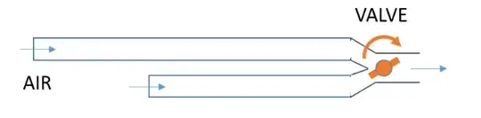

My Interpretation
This car has a dual air-intake setup, and the "power valve" is a vacuum-operated means to select which intake tract the air flows through.
Variable Length Intake
Based on the description above, the shorter runner is intended for high RPM conditions, the longer one for low/medium RPM conditions. There is no "in-between" condition where air is being fed in from both runners.
The lean AFR could be the result of a mismatch between what intake runner the engine management is expecting and what is actually being used.
It may also explain why a smoke test returned negative for leaks.
