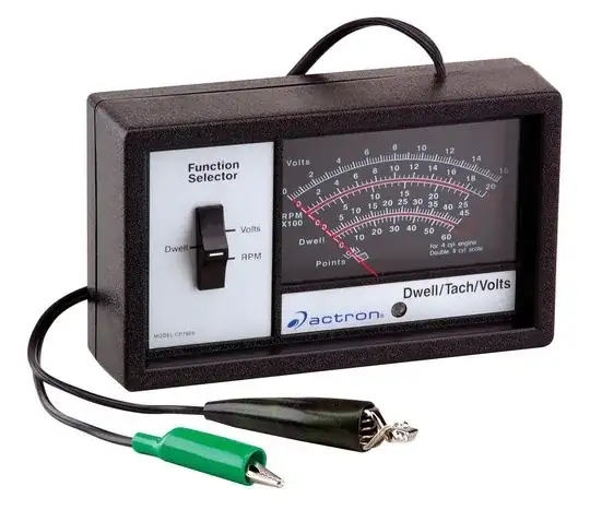

You have a few options out there. There are meters that clip onto the ignition system that show the engine RPMs that are quite simple and cheap:
Tach meter at Amazon for example...
You can also pick up a "timing light" that has a tachometer function. Either of these tools have other purposes for a shade tree mechanic, so find one that you think you will use the most.

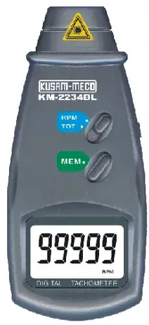

Yet another option is a digital, optical tachometer.
They use a laser to bounce off of a reflective object (like the blade of a fan) to measure RPMs.
All products and images for illustrative purposes only. I've never used those in particular.

You can also use a dwell/tach meter. These are useful because they typically work in a range of 0-1000, so you can more accurately see the RPM you are trying to achieve. A dwell/tach is best if you have points and need to set the dwell also.
