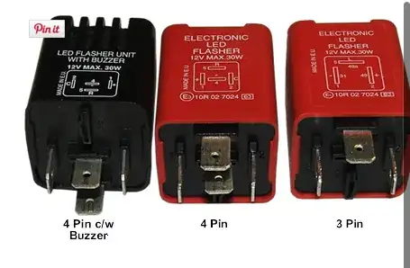

I know you can replace the relay for the lights so that it works with LED properly. Do you know what I need to do in order to fix this? I've found these plugs but unsure if I need to replace something that's there or add into a blank slot - http://www.autobulbsdirect.co.uk/LED-Flasher-Unit.html?gclid=CPiKweC03MoCFckaGwodt-8Pow

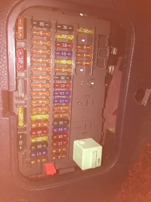

Below is the fuse box and fuse box diagram for reference:

The relays you have shown in the link are the typical relay plug pattern. If these are the correct pattern for the Cooper (I haven't found the exact one yet), then you can use it without putting a resistor into the wiring at the bulb end. As long as this fits, it's all you'd need to make it work.

I know this is an old question, but in the off chance someone else is looking for the answer, new Mini Coopers do not have a flasher relay. The flashers are controlled by the BCM. You will need to wire in the resistor to cure the fast flash issue.
