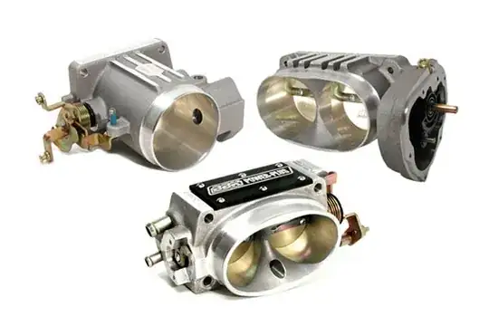

Here is a picture of what a TB might look like:

In very simple terms, the TB is just a restriction in the intake. Without something like it in the way of air getting into the system, the engine would run up to it's maximum (if it had the fuel as well) and would soon self destruct. It'd be called a runaway in the diesel engine world.
Since the TB is just a restriction, when we open the butterflies, the TB can allow a certain amount of air in. Usually, the larger the bore (or opening of the TB itself) the more air can pass through. In SAE terms, this is usually measure in cubic feet per minute (CFM). A larger TB can flow more CFM. How this might affect the power curve of an engine is by allowing the engine to take in a larger amount of air. If an engine can take in more air, it can potentially have a higher RPM and thus a great chance for more power output.
You may be wondering why I highlighted potentially in the above paragraph. The reason is, even with a larger TB, the engine will only be able to use as much air as it can use and no more. Adding a larger TB is only one small piece in the puzzle for affecting the power curve of the engine. If an engine cannot use more air, buying a new or larger TB isn't going to automatically be granting the engine more power or allow it to change the power curve.
