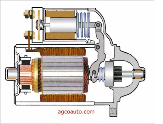

This image shows how it works, the solenoid is the top part, the motor is underneath it.
