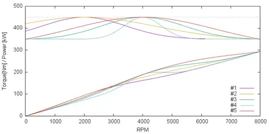

This diagram shows a few curves of five theoretical motors:
Each motor has a torque of 350Nm at 8000RPM (and so the same peak power at that RPM), and each motor has a peak torque of 450Nm.
A normal driver uses the range up to 3000RPM on the street, so his best choice is motor #2 followed by #1. Those would give best acceleration at moderate RPM.
In a race where the motor runs at very high RPM, you'd better chose #5.
This evaluation can be done with both curves - power and torque, because they show more or less the same quantity. BUT the torque curves show the differences much clearer than the power curves!
However, the power curves (can) show some interesting details. The power of #4 decreases between 4000 and 5000RPM. Another point is that usually, max power is not at max RPM, and you want to know at what RPM it is, and how it behaves around that RPM.

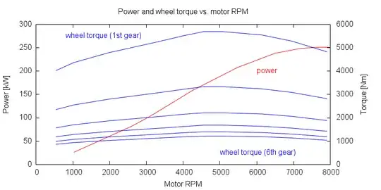

What happens in the gear box(es)?
As said, power is work done per time. Since power is conserved, the power at the motor shaft equals the power at the wheels. From the formula above one can calculate what happens when the ratio of motor an wheel ratio is different (neglecting any losses):
Wheel_torque = Motor_torque * Motor_RPM / Wheel_RPM
In my next diagram, I've plotted the wheel torque vs. motor RPM for the six gears of a BMW M3 (365Nm@4900RPM; 252Kw@7900RPM):

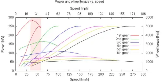

But it's also possible to draw power and torque vs. speed:
Yes, the 365Nm of the motor is transformed to almost 6000Nm (4400lb ft) in first gear. This shows the massive impact of gear ratios as well as wheel dimensions. On the other side, power is always the same at a given RPM.
Note that when you shift into second gear at or around 4900RPM (max torque), you reduce the wheel torque by about 50%. (And when you shift into 3rd later, you loose again about 50%).
This means, in a race you will shift as late as possible, even if also power already falls, because shifting means a heavy loss in power / torque. (The red area in my plot just marks the RPM range from 4900 to max in first gear to make this clear). However, in an acceleration contest where you start from zero, high torque at low RPM will help, because it's important to get to high speed as fast as possible, and it doesn't matter that much if you still accelerate a little on the last meters.
Of course, in reality there is drag and so which increases with speed, and the only way to overcome it is even more power. Thus, power of course defines top speed, but this example shows that power already plays a role in the range of 50km/h / 30mph, which is not really fast.
