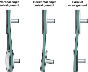

If the belt is rubbing a misaligned pulley, then one of the pulleys has a different offset (parallel misalignment) or a different angle (angular misalignment) than the rest. Parallel misalignment occurs when the pulley is not pressed onto the shaft far enough or pressed too far. This can be checked by placing a straight ruler across adjacent pulleys - they should be perfectly parallel. There might also be lateral looseness in the pulley because of a failing bearing, which would not be shown by this test. If the misalignment is angular, it is likely caused by a worn bearing as well. In either case a bearing problem can be found by taking off the belt and grabbing each of the pulleys, giving them a few tugs and shakes - there should be practically no wobble.
Pulley misalignment types
(borrowed from flowcontrolnetwork.com)
