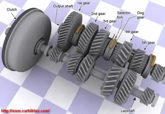

Here's an image of a gearbox. I couldn't find a one with synchromesh, just assume that it goes where the DOG GEARS are. CONSTANT MESH GEARBOX
HEEL AND TOE - This is a driving technique for DOWNSHIFTING while BRAKING.
The point of doing this is REV-MATCHING the engine with the new transmission speed after engaging a lower gear and doesn't help the synchromesh unless you're DOUBLE CLUTCHING as well.

By double clutching, you're trying to REV MATCH the lay shaft/neutral shaft, which on a constant mesh gear box is constantly meshed with all your gears, to the OUTPUT SHAFT , which is connected to the synchromesh and mates to the selected gear.
