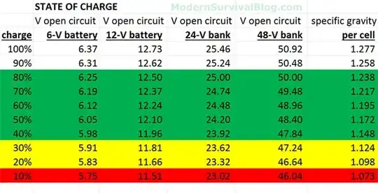

If the problem is a soft battery, and nothing electrical was left on during that hour, you might have a bad alternator that's not charging the battery well. The easy way to tell if it's the battery or not is to measure the voltage across it with everything turned off. To be really sure nothing is pulling current from it, disconnect the negative and then the positive battery leads. Now measure the voltage across it. If it's below 12 volts DC, this is your likely problem. Here's a chart of battery voltage as an indicator of charge state:
I hope that helps to at least get you pointed in the right direction.
