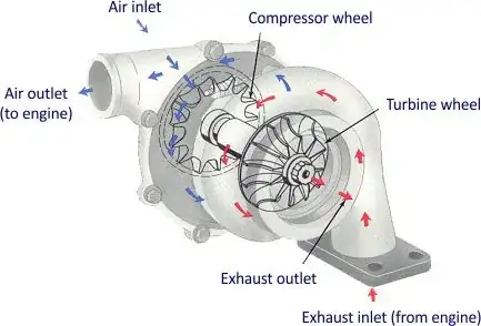

In almost all automotive applications that you are likely to see, turbos are a radial flow, snail shaped turbine section attached to a similar compressor section. As we see in this illustration from the Turbocharger Fundamentals article:
Illustration of turbocharger from Dieselnet

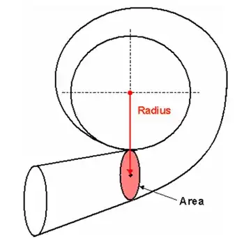

How is it computed?
Garrett turbo illustration of A/R ratio
The cross-sectional Area to Radius ratio is a consequence of our desire to turn linear energy (the exhaust gasses coming out of the manifold) into radial energy (we need to spin those little wheels). We need something that strongly resembles a funnel that has been stretched and twisted into a spiral.
For example, look at the exhaust inlet: this is a relatively large fitting that accepts all of the exhaust gasses. As the piping spirals into where the turbine wheel waits, the radius of each turn decreases. In order to preserve smooth flow, the cross-sectional area of that piping also decreases at a rate proportional to the decrease in area. The result is a constant A/R ratio.
