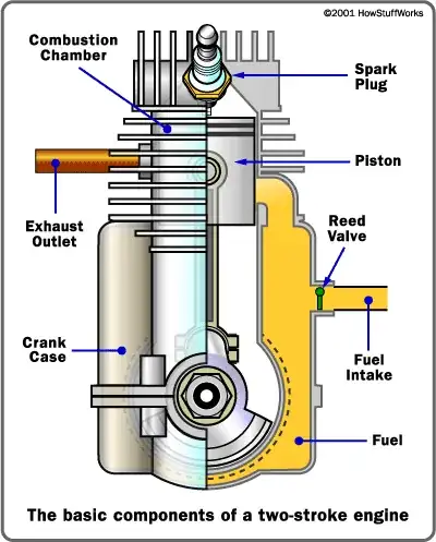

Just so we're on the same page as to how two strokes work, here's a pic. I had to look it up because I had the wrong picture in my head.
Two Stroke Motor Anatomy
In looking at how the cycle actually works, the power stroke goes off creating the combustion products and power. As the downstroke begins the pressure in the cylinder is high allowing the exhaust gases to escape and forcing the intake reed valve closed. As the upstroke happens the pressure in the cylinder is now low because the escaping exhaust gases cause a small pressure wave of escaping gas that now opens the reed value and draws in new fuel / air mixture.
It seems like some key reasons for the engine being inefficient:
  • The cylinders are not scavenged of exhaust gases by the piston forcing them out, they simply escape because the outside air pressure is lower than the cylinder pressure after the spark ignites the fuel. This would lead to incomplete expulsion of the exhaust gases. The volume consumed by those leftover gases prevent more air / fuel mix from being ingested.
  • As the upstroke happens, for some part of the travel the air / fuel mix is also being expelled. Thus wasting fuel as it's expelled.
    Maybe these problems are solved in larger two strokes but the small ones drive things like weed cutters, snow blowers, lawn mowers, etc, small engines for limited applications. Not driving cross country. For these small engines parts count and cost are much more important, so they work really well for those applications.
