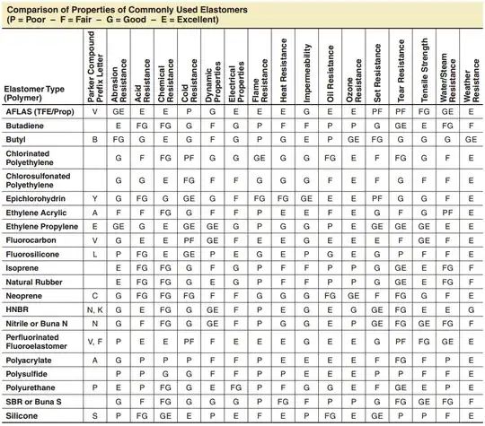

Looking further into the handbook will give you this matrix of how well different types of materials fair against different things:
Looking throughout the matrix you can see that natural rubber does very poorly against oil, while Neoprene does fair to good and Nitrile does excellent. (Note: Even though EPDM is said to be used as one of the big three substances, I'm not finding it on the list.)
