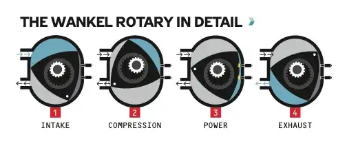

  • Shape of Combustion Chamber - In the following image, you can see the basic Otto cycle in the Wankel engine. Due to the inherent shape, when the air/fuel is ignited (between #3 & #4 cycles), the flame front is chasing the leading edge of the rotor around the combustion chamber, but never completely catches up with it. This allows some of the air fuel mixture to escape out of the exhaust port as that port is uncovered. This is why you can sometimes see flames coming from the exhaust of a rotary engined vehicle.

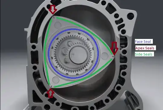

  • Rotor Sealing - On the rotor itself, there are three main seals which keeps everything in check: apex seals, face seals, & side seals. (Below is an image showing their locations.) Keeping all of the gasses in their respective locations is a chore for the seals and the seals will usually lose some of that integrity. One of the reasons for this is because the seals have to keep hot and cold unmixed at the same time.
  • Engine Oil Injection - In order to help in keeping a good seal, engine oil is injected directly during the intake cycle and in the intake tract. This provides proper sealing and decreased wear, but introduces inefficiencies in the burn of the air/fuel mixture, as well as creating more pollutants in the exhaust.
