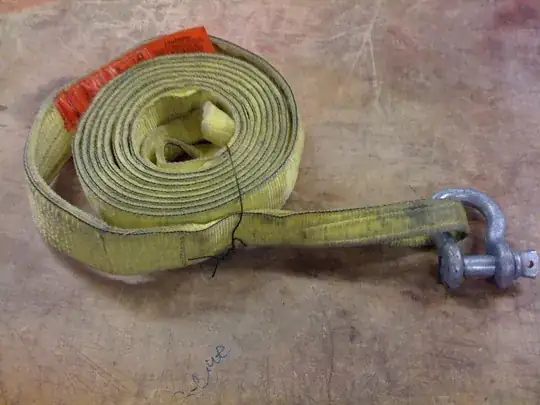

You can move the vehicle with a heavy duty strap.
Vehicles usually have hooks to grab onto for towing. If you have difficulty locating them you can always wrap on to the front and rear axles.
Here is an example of how it is done. You must have someone in the vehicle being towed, and ensure the brakes are in working order. If you are concerned about damage, you can strap a tire to the rear section of the car that is doing the pulling.

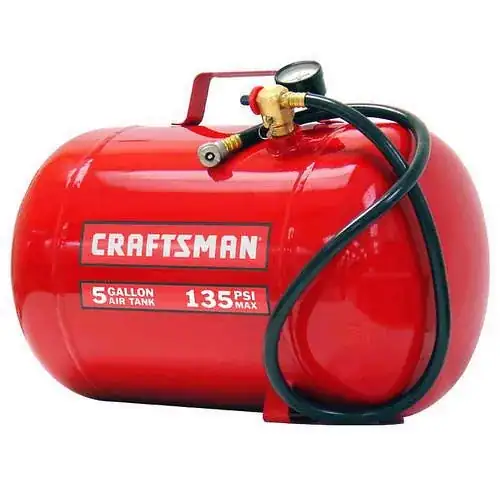

You mentioned there may be difficulty with a low tire. If the vehicle is not near a compressor, you can bring a portable one to you!
Behold the Air Pig!
Depending on the size of Air Pig you have, and how low the tire is, you may be required to fill it up, (with a compressor) multiple times.
