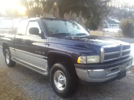

It's a 1999 Dodge Ram 1500 4x4, Laramie SLT, automatic transmission, 5.9l magnum engine, and crew cab (222k mi).
I have a friend who could put a cold air intake on it, with a new hood. But I have a few questions.
  1. Would there be a substantial enough of a horsepower boost to be noticeable?
  2. Would the truck perform in the rain as well as before?
  3. Is it safe to put this kind of performance part on an old engine with high mileage?
I would like to be sure it's worth it before buying any parts.
