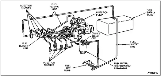

I've had a couple of situations with diesels. One in particular where I swapped a Ford F350 Powerstroke 7.8 transmission. When I was done. The truck wouldn't start. It was a painful troubleshooting situation for me because of my diesel ignorance. It turned out that the fuel lines needed to be bled.
It made no real sense to me but it was the solution. The fact that air was in the system at all didn't make sense to me.
My Question
Why do diesel fuel lines have to be bled?
Here's a generic diesel fuel system image

If you have changed major parts of the engine/transmission, you have almost certainly introduced air into the fuel lines or injection system. This will prevent fuel getting to the engine as the fuel injection becomes "airbound" - ie it can no longer pump the diesel through.
Bleeding the fuel lines is as simple as starting from the tank and using the fuel pump (either electric or mechanical) be sure you have pumped fuel all the way through the lines to the injectors so there is no air left in the lines.
Some systems have a series of bleed valves along the way, some only have one, but you need to allow air to escape each one until diesel starts to escape, then you close the valve.
