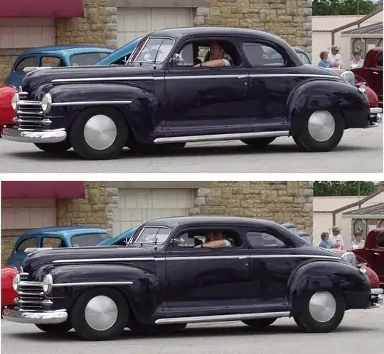

Chopped and channeled refers to two different things, but are usually done together to create a specific look usually utilized by hot rodders.
Here is a decent attempt at a Photoshop "chop job" (pun intended), but it is a pretty good representation of a before and after of what it would look like:
In this image you can see the top is lowered. The basic events would occur something like this:

The main reason someone would do either of these processes to a car is strictly for aesthetics. It's just the way the person wants a vehicle to look.
Negative effects for chopping the top are head room for the driver and passengers. To compensate, the seats can be lowered or lower seats added to accommodate. Doing this, though, makes it harder to see around the vehicle (line of sight). In all things there is a trade off.
