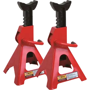

For safety sake, don't get under the car unless you have some jackstands. It isn't the jack failing that kills you. It's the fact that you only used a jack and didn't have any backup. You NEVER use a jack alone if you are getting underneath the car. You ONLY use a jack to change a tire on the side of the road and
you never get underneath your car without jack stands in that situation...NEVER
If you don't have access to jackstands, take the spare tire off your car and jam it up under the car. If it doesn't take up enough space, don't get under.
Do these things
  • Put the car in park
  • Use the emergency brake
  • Find anything you can to use as wheel chocks. 2x4 is better than a rock. A rock can skid along smooth concrete if you are on a slope.
  • Don't jack up the car if it's on a slope, no matter what. Especially since your are a 'jack your car up virgin'
  • Put the car on level ground
  • Use jack stands
  • Use jack stands
  • Use jack stands
  • If you don't have jackstands, use two of your wheels. The spare and another off the car. Jam them up in there. Make sure the car won't fall more than an inch
  • Make sure you jack your car up per your owners manual. Get it out of the glove box and open it. It will tell you where to place your jack.
BE SAFE, BE SAFE, BE SAFE, BE SAFE, BE SAFE
If you feel uncertain, don't do it. Ask a neighbor who has done it before to help you. Call your friends. Have them come over and help you.
Have someone with you in case something happens and you need help. Do not do this alone since it is your first time. Don't do it alone. DO NOT DO IT ALONE. Have your GF/Wife there. Anybody. The moment you feel uncomfortable abandon the project and find someone to assist.
This post makes me incredibly nervous because you have not done this before.
Please be safe.
Edit:
Your jack placement is very important. If you place your jack incorrectly it can damage your car. I already said this piece but get the owners manual out of your glovebox. It will tell you EXACTLY where to place your jack. There are points the manufacturer designed into the car for you to jack it up. You will want to use those hardened jack points.

Have jack stands and a plan
  1. Position the car on a flat surface solid surface and give yourself work room
  2. Lay out the tools and parts
  3. Emergency brake, park or reverse, and chock(s)
  4. Have a plan for exactly where you are going to jack and place the stands
    The owner's manual should have in instructions for both
  5. If you have room then place stand(s) - then raise them more later
  6. Loosen the lug nuts
  7. Jack the car enough to get the wheel off the ground
  8. Raise / place the jack stands
  9. Slowly lower the vehicle onto the jack stands
  10. Give the car a good push
    Is it stable?
  11. Remove the wheel
  12. Even with all those precautions only go under the vehicle when you need to
    Don't sit cross legged with your legs under the brake
  13. Reverse the order to bring the vehicle back down

When I was doing drag racing, one guy on our bulletin board died because his jack failed. This stuff does happen and the risk is real. As everyone said before: Use jack stands, and if you don't have any: go buy some. They're cheap and your life is worth a lot more.
