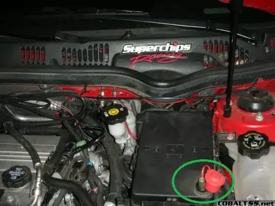

You need to jump start your car. Pop the hood. You'll see something like this:
Inside the green circle is the positive jump point. Connect the red jumper cable clamp there first. Find an unpainted ground spot and attach your negative clamp there. Once connected to the donor car, you'll have power to do what you need ... either start the car, or pop the trunk to get to the battery.
