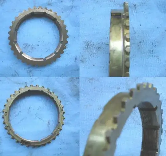

Synchronizer rings
Modern transmissions use synchronizer rings to make manual shifting possible without the need for double declutching.
"Sincronizzatore" by A7N8X - Own work. Licensed under CC BY-SA 3.0 via Commons - https://commons.wikimedia.org/wiki/File:Sincronizzatore.jpg#/media/File:Sincronizzatore.jpg
Each gear has its own synchronizer ring. These rings are subject to wear. If they are in bad condition gear synchronization doesn't work well and you have trouble putting in a certain gear.
