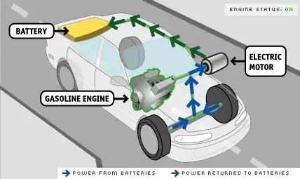

I know that many electric cars use regenerative braking to enable the car to become more efficient by converting what would otherwise be lost heat energy in to a more useful, reusable form of energy.
Regenerative Braking
Surely, there must be some way of engineering a new brake design that would allow for the use of this technology on a more conventional car powered by a normal internal combustion engine.
What I don't understand is:
  • What exactly is regenerative braking?
  • Why can we only use regenerative braking on electric and hybrid cars?
  • Is there any reason why we can't use this clever braking technology in order to increase power to the crankshaft or reduce fuel consumption?
Image Source: http://sjam4uphysics.pbworks.com/w/page/38936885/Regenerative%20Braking
