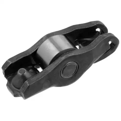

I believe this is the part you are looking for:
If so, it's called a rocker arm. The most probable reason for its demise is metal fatigue or maybe it just broke.
Looking at this forum (and others), it appears that these were designed to fail in case of catastrophic cam belt failure. With that in mind, it's not inconceivable that one of them has broken just out of usage. You can readily buy replacement rockers to fix this issue. You probably want to inspect all of the rocker arms very closely to ensure others aren't ready to fail as well. A cautious person with money to burn might also want to replace all of the rockers just to ensure they are all on an even footing (as far as usage goes).
