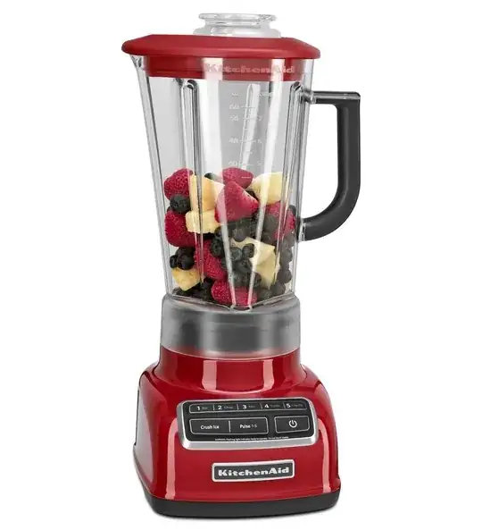

How can I convert the DC current from my battery to power the blender in the Jeep?
The only solution is a 12V DC to 110V AC inverter. Google is full of this, so I just linked google.
Your blender has nearly 400W, so you should look for something in the 500W range to have some margin. However, this makes 400W/12V=33.3A, which is very unlikely to be delivered by the cigarette lighter socket. So you have to connect it directly to the battery. Use thick cables, and definitely a 50-60A fuse in the positive line, not too far from the battery.
Also keep in mind that 33A is pretty much. I only have a cute 40Ah battery, so 30 margaritas, and not only me, but also the car couldn't drive any more. I guess your Jeep has a bigger battery and will last longer, and when you concentrate more on fishing, you'll also not make that many margaritas, and it will be fine.

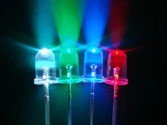

Should I procure AC LED's or DC LED's for my blender lighting solution?
Well, LEDs typically need up to about 3.5V DC, but as you said, there are 12V types, too. You could connect these directly to the 12V of your car. The longer leg / leg where the plasting flange is flattened a little needs to be connected to minus (chassis).
I'm not aware of any LEDs which you can directly connect to mains voltage. However, it sounds strange to convert 12V DC to 110V AC, and this back to 12V DC to power the LEDs...
In case you do NOT have 12V LEDs, you should connect each LED to 12V via a resistor:
plus ----|====|-----|>|------ minus/chassis
        resistor    LED
The resistor needs to have the value
R=(14-Vled)/0.02A
since the maximum voltage in the car may be up to 14V and an LED usually sinks 20mA. The nominal voltage Vled of the LED varies from type to type.
