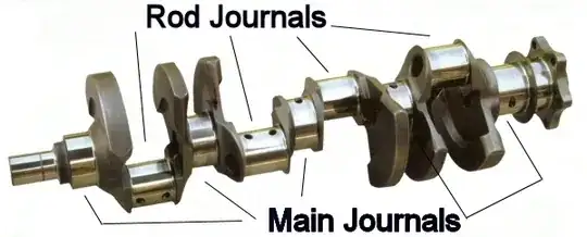

Crankshaft - its the red one!
Image Source: https://en.wikipedia.org/wiki/Crankshaft

There are two types of journals on a crankshaft.
  • Main Journal - Where the crankshaft main bearings would be located
  • Rod/Offset Journal - Where the connecting rod bearings would be located

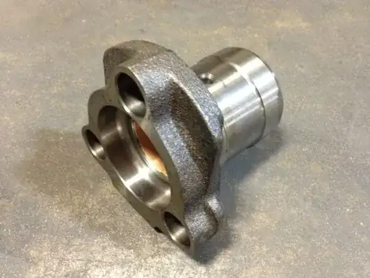

Crankshaft Components Image
Roller Bearings are frequently pressed onto the crankshaft during assembly. In order to replace bearings that are fitted in this fashion the crank pin/journal needs to be pressed out of the counterweight.

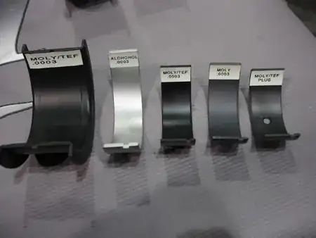

Plain Bearings split in half and are typically associated with crankcases that can split or support main bearing caps. This also true of connecting rods on offset/rod journals. Plain bearings wrap around the journal and are pressurized with oil, the crank journal 'rides' on this layer of oil between the crank journal and the plain bearing. This is called hydrodynamic lubrication.

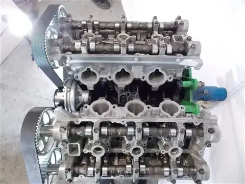

There are many different designs of cramshaft end bearings. There may be a cap with a roller bearing or a needle bearing in it, as in the image below or simply a cap over a camshaft main journal.
A camshaft end bearing is also designed to reduce lateral movement of the camshaft in order for it to stay within a given lateral tolerance so the cam lobes always ride on the correct valve bucket or rocker arm.
The image below shows the use of camshaft end cap bearings in use.
