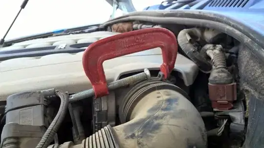

My Touareg has the intake piping secured with a bunch of spring-type hose clamps.
I currently use a miniature C-clamp to expand them, but it is painfully slow, prone to slipping and access can be a problem at times.
Spring Type Hose Clamp
I have a pair of bent-nose pliers but they don't open wide enough. Before sinking funds into acquiring a bigger version of it, I was wondering if there is something that keeps the clamp expanded without keeping one hand busy.
So is there a more convenient, purpose-built tool for the job?

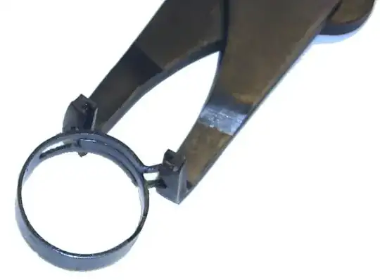

You can use this tool to get the job done.
They are called Hose Clamp Pliers.
This is not the right tool

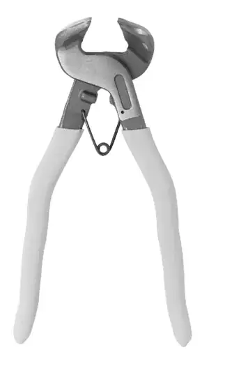

If nothing else is available, I'd consider boot-pinch pliers, aka nail puller pliers, because the sharp edges will go under the lips and its going to be less likely to slip off than the C clamp.
Of course the right tool (as per other answers) would be much better, but for a once-off task then the right tool is quite expensive.

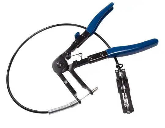

Slip joint pliers can do the job quite well, but I usually use a pair of Vice Grips. There is, however a tool made for this. Here's an image of one:
It's called a: Spring Clamp - Flexible Ratchet Tool
