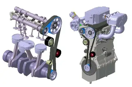

They tend to consist of only three cylinders rather than the more traditional 4 stroke, 4 cylinder engines that many people are using today. There are two small small high-pressure cylinders and one larger low-pressure cylinder. This video has some good information and animations.
5 Stroke Engine Image
