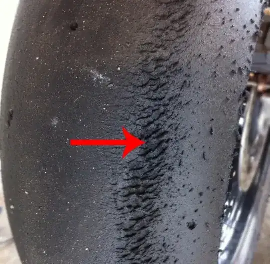

The core issue frequently over inflation in combination with cold tires and cold track. Your friends caution in the morning is well served. Go out on old tires, clean the track and do laps with the rest of the field, take it easy and ramp into the fresh tires as the sun begins to heat up the track.
The tires will look like this
