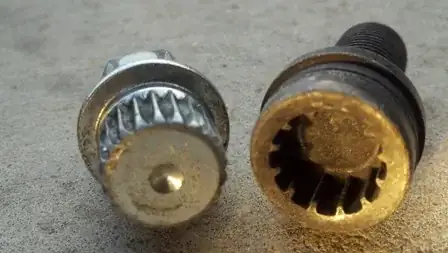

Depending on who asked you, and why, I would assume they were talking about the special socket needed to removed locking lug nuts from the car. On cars that have them, one of the 4 or 5 lug nuts/bolts will have a smooth outside and a special pattern on the inside that only a certain key will fit.

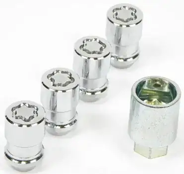

In a car normal lug nuts or lug bolts in your case have some type of hex head. This can be easily removed with a lug wrench or a ratchet and socket. This also make wheels easy to steal. To counteract the theft there exist special lug bolts that have a non standard pattern. This pattern requires a key to covert the special pattern to a standard hex. This is roughly what your lug a key can look like.
The key can be kept in the glove box but in reality the key could be anywhere, even not in the car. VW commonly has a zip tie device that affixes the key to the lug wrench in the trunk area near the jack.
