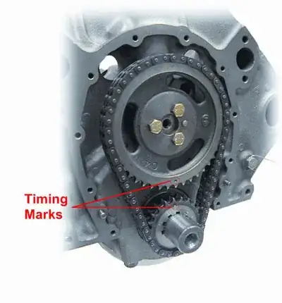

If a camshaft is being replaces due to damage or malfunction with another OEM camshaft generally the degreeing process is not performed. When the camshaft is installed a set of timing marks is lined up and this lines up the camshaft. The following is just one possible setup, every engine has a different alignment procedure.

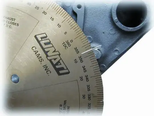

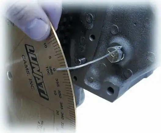

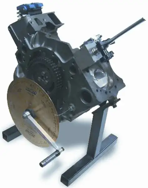

First install the camshaft and alight the marks available. Next rotate the engine to the top dead center of the number one cylinder. Next install the degree wheel, an indicator of some kind (a bent wire in this case) and something to turn the engine with (a crank handle in this case).
Next adjust the engine to make sure it is exactly at top dead center. There are lots of ways and tool available to do this. I like a dial indicator. Adjust the degree wheel so that the top dead center of the engine, degree wheel and wire indicator all match.

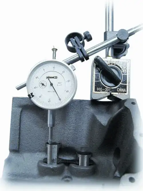

Now place a dial indicator on the number one intake lifter and rotate the engine backwards until 0.050 inches of lift is achieved.
Once the lift is achieved the read the cam wheel.

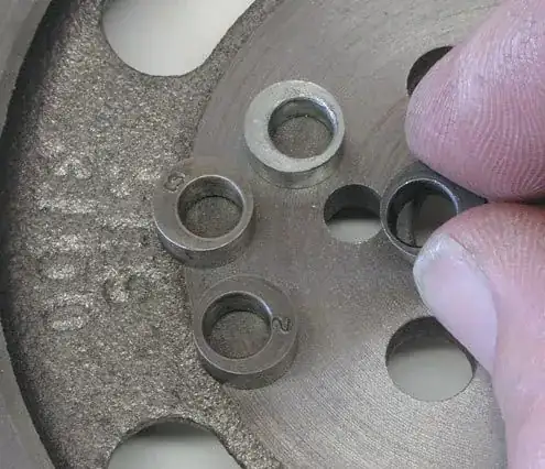

If this matches what the manufacturer specified then your all done. If it does not then the camshaft orientation need adjusted. This is usually done with a special gear or key way. For example, for this small block a special gear is available that takes inserts that offset the relationship between the camshaft key and the gear.
