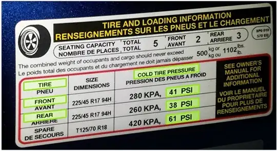

On every car sold (that I'm aware of) there is a sticker pasted, usually in the door jam of the driver's side, which states exactly what the car manufacturer suggests your tire pressure should be at. It will give a front/back pressure. This is what you should use and not what the pressure on the side of the tire says. The figure on the tire is the maximum which the tire should be filled to, not what your car is expecting.
Here is an example:

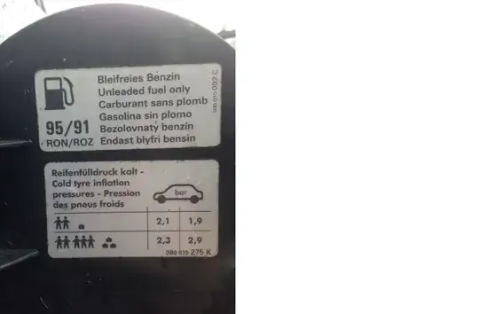

Correct Tire Pressures
As @Random832 mentioned in the comments, the information for my 2004 VW Passat B5 was not in the door jam of the drivers' side, but rather it was actually on the inside of my fuel filler lid. Here is what it looked like:
Fuel Lid
As you can see, the pressure here varies for the approximate amount of weight that the car is carrying, but also the pressure is only in bar. Given that 1 Bar = 14.5038 PSI (Pounds-Force per Square Inch) approximately, here are the manufacturer recommended tire pressures for my 2004 VW Passat B5:
| Weight | Front Tires | Rear Tires |
| Light  |          30 |         28 |
| Heavy  |          33 |         42 |
All values in the table are recorded in PSI and rounded to the nearest integer.
Sidewall Markings
As @Paulster2 mentioned, the PSI markings on the sidewalls were maximum values and should never be filled to this pressure for normal driving usage. The design of the car was not optimised for these higher tire pressures. It could also be dangerous if your tires are at the maximum and you drive over a large pothole of something similar.
