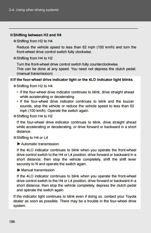

On page 186 of the owners manual there are instructions that tell you what to do when this indicator blinks. Highlighted below:
(highlight added for emphasis)
Given that you've tried shifting to different modes several times, you may not know what mode it thinks it's shifting from. You may be able to simply go through all the possible sequences described above.
If you go through all the possible sequences above and it's still blinking, the dealership or a suitable mechanic may be your only resolution.
