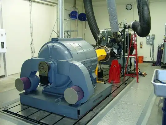

An engine dynamometer (dyno for short) measures the torque output from the crankshaft of an engine directly. Here is a larger engine dyno with an engine attached to it:
The engine attached to it appears to be a Detroit Diesel engine. Note that the engine is only attached to the dyno via an output shaft (covered by the yellow piece).

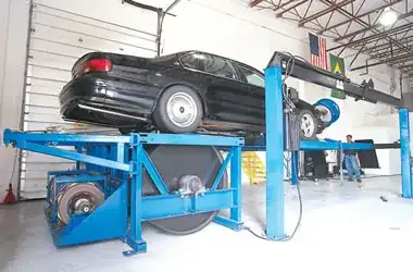

A chassis dyno measures the torque output of an engine as seen at the tires. Here is one which is above ground and with a car on top of it:
In the picture you can see a large cylinder underneath the rear (drive) wheels of the vehicle. Attached to the large cylinder is the measuring device for this particular model.
