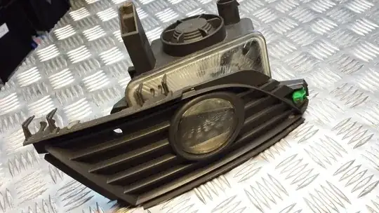

I need to replace my front fog light housing before my MOT as it's completely ruined.
What is the best way to do this?
DO I need to take the entire bumper off?
The image below is what I'm replacing

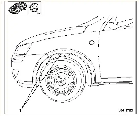

Firstly, we need to remove the inner paneling (basically the bumper):
  1. Release left and right front wheel cut-out panel
    • Unscrew 4x nuts (1)
    • Pull out wheel cut-out panel slightly and fix in place

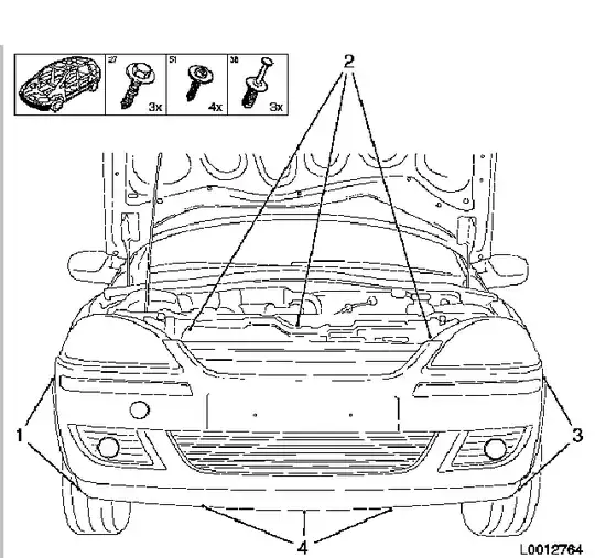

  1. Undo front panelling at top
    • Unscrew 3x bolt (2)
  2. Release left and right wing protective liner
    • Unscrew 4x bolts (1) and (3)
  3. Undo front panelling at bottom
    • Remove 3x body-bound rivets (4)
  4. Remove front panelling
    • Release panelling from guide rail at the side
      Note: This requires a second person

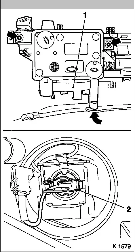

  2. Remove cover to change bulb (1)
    • Disconnect wiring harness plug
    • Unlock retaining spring (2) and remove bulb
