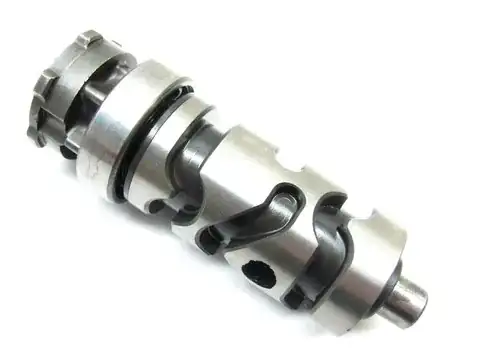

Shift Drum Image
The shift drum has grooves around the outside of the drum that the ends of shift forks ride within. As the drum turns the grooves will shift for a particular shift fork sliding gears along the primary shaft or secondary shaft back and forth and placing them into locking positions to maintain a particular gear.

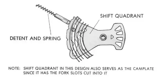

Cam Plate Image
Notice the grooves where the shift forks are aligned to

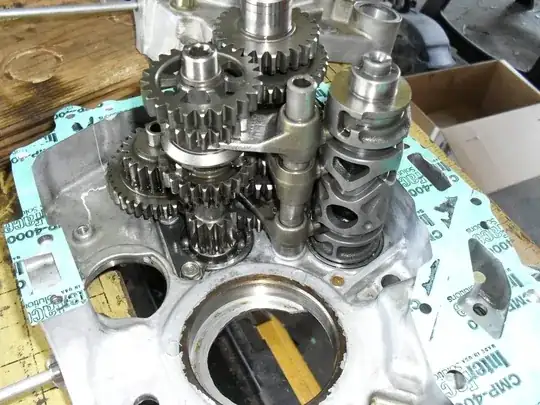

Shift Drum and Transmission Relational Image
This is an excellent example of a v-twin engine with vertical cases split. As you can see, it illustrates the relation of both transmission shafts with shift forks and the grooved shift drum.
