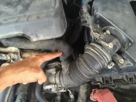

I had approximately the same problem and finally solved
Slow acceleration ( when you press on the gas pedal the rpm rise but acceleration is very slow )
The problem was a small crack in the pipe which connected from air filter to machine and this makes air leak. change the pipe and now big difference in acceleration. So, before changing any part first check all air pipes.
I got this solution after changed many pieces such as air filter and oil filter .... but It did not make any difference.
