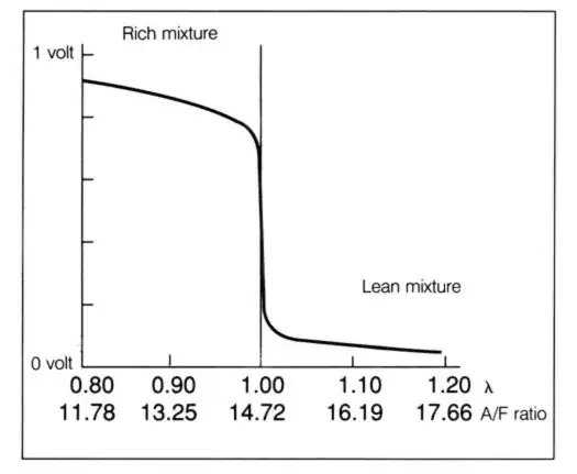

  1. Narrowband
    These qualitatively detect whether the exhaust gases are rich or lean.
    The most prevalent type of sensor is the zirconia-based narrowband, which generates its own voltage as signal output:
    • useful voltage range 0.1 - 0.9 V
    • stoichiometric AFR at 0.45 V
    • low voltage = lean condition, high voltage = rich condition
    Narrowband Voltage Graph
    The rarer titania-based variant does not generate its own voltage, but changes electrical resistance based on the oxygen concentration detected.
    • low resistance = rich condition, high resistance = lean condition

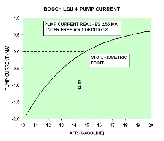

  2. Wideband
    These quantitatively measure lambda.
    Changes in AFR translate to changes in current output, which is then converted to a corresponding voltage. The voltage range may vary between car manufacturers.
    • low current = rich condition, high current = lean condition

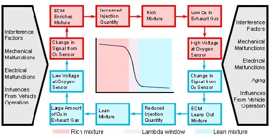

Impact on fuel management
The diagram below nicely summarizes the impact of lambda sensors on fuel injection management:
  • lambda sensor senses leaner-than-desired exhaust → increase injector pulsewidth
  • lambda sensor senses richer-than-desired exhaust → decrease injector pulsewidth
