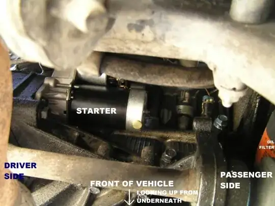

I went to replace the starter on my car, and I can't for the life of me reach that top bolt. I removed the bottom one just fine, but I've spent maybe 2 hours trying to find the top one and I just can't. It's totally blind.
How do I find it?

You'll need about an 8" or 10" extension. Use the same 13mm socket as the bottom one. You'll also have to work blind, but it is (I believe) exactly opposite of the bottom one. Put the socket/extension up on the top side of the starter and find the bolt. It shouldn't be too difficult. Also, make sure all of your power is disconnected before you do it. Here is a video showing you what you need ... I've queued it up to the spot where he's showing you what you'll need. It appears to be more difficult than it really is.
