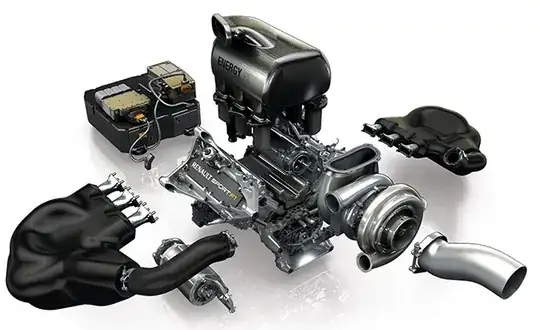

How it works
There are two energy recovery systems. A kinetic system called the MGU-K which is driven off the crankshaft and a heat recovery system via the turbocharger called the MGU-H.
FI Hybrid Engine
MGU-K (Motor Generating Unit Kinetic)
Harvests electricity via a generator off the crankshaft.
What you are interested in
This is the component that harvests energy from the turbocharger.
MGU-H (Motor Generating Unit Heat)
Harvest energy from the turbocharger shaft on deceleration and stores it in the battery. As the turbine is spinning, after it is prespun to act as an ALS (Anti-Lag System) system, it is harvesting energy from the exhaust. Upon deceleration it continues to act in this manner, harvesting energy as an alternator.
Upon application of the throttle the polarity of the alternator can be reversed turning it into an electric motor. When the MGU-H is in this mode of operation it can pre-spin the turbocharger up to 120,000 RPM's to use it as an ARS to spin up the turbo before the vehicle operator applies throttle. This pre-spinning of the turbo prevents turbo lag and charges the intake tract with compressed air/fuel to provide immediate power once throttle is applied.
