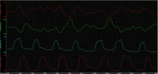

It's my understanding that under normal operation spark advance is directly proportional to RPM, i.e. as RPM increases so does spark advance due to the need to ignite the AFM earlier the quicker the piston is moving.
So I was somewhat surprised when I saw this graph from my 98 Mazda 626 while it was idling:
As you can see, the spark advance here is inversely proportional ( a mirror image ) of the RPM graph.
I'm not sure which is the cause, and which is the effect, and generally why there would seem to be such an odd relationship between the two at idle.

Most of my knowledge here is coming from working on my 1970 Chevy Pickup, so some of it may not be exactly accurate for your vehicle...
There are basically 3 things you need to consider for timing - engine RPM, air/fuel ratio, and volume of air fuel mixture in the cylinder.
Engine RPM is simple, as the engine spins faster, you need to ignite faster to compensate.
A/F ratio - Richer needs LESS advance. More fuel burns faster.
Volume of A/F mixture - more volume = less advance. If you have more air and fuel, it will burn much faster. This is what vacuum advance takes care of on older vehicles. Think of the amount of air/fuel in your cylinder at idle versus the amount at WOT.
On the small block chevy's (and I believe most carb engines) you typically set the timing for all in at ~36*. You hit that 36* early, like 2200 RPM and it will stay there through the rest of the powerband. Vacuum advance adds ~10-12* of advance at idle and 0* at WOT.
By the way, I can't see your image, so I don't know the range we are working in here. This is not your fault, I'm at work...
What might be happening, likely a combination - ECU is richening the mixture to help counter the heat in the cylinder (common at WOT)
ECU is pulling timing to be safe at higher RPM.
If you were not wide open, then went wide open, the timing should retard quickly.
I believe volumetric efficiency increases with RPM (especially on a DOHC engine)
Incorrect. It depends on the application. Your vehicle, which is old in terms of engine controls and technology, will tend to try and advance spark at idle and run a little lean for emissions purposes.
A new vehicle that has direct injection, variable valve timing (and possibly lift) will usually (not a rule of thumb, though) run less timing due to the fuel being injected at higher pressures.
In my many adventures tuning high performance turbocharged cars, the timing is black magic that varies from car to car. :)
race fever
  • 3,353
  • 13
  • 23
This graph does not give enough to be definitive. Here is a theory. A lean cylinder causes the crank to slow down. This is the best explanation for the cyclic dip behavior of the rpm at idle. The lean cylinder also explains the slight upward jump in timing since the PCM responds to lean with an increase in timing. Lean mixtures burn slower and therefore must be ignited earlier to keep that cylinder at the maximum brake torque timing point.

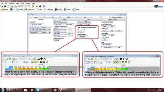

So a guy named Spence gave a great answer to this question over on the Autonerdz forum which fleshes out something I found in the book, Automotive Technology, A Systems Approach:
Basically, the PCM uses spark advance ( or retard ) to make adjusts to idle speed in order to try and hit it's target RPM at idle.
So from the example above if the actual RPM is 12.5 less than the target the PCM will add 3* of advance, or if the RPM is 12.5 more than the target it will retard the timing by 3*.
The underlying cause is a whole other question, which, like @FredWilson said, we don't have enough information to answer yet. I found another log from around that time which shows that the LTFT was hanging around about 1-2%, which makes me thing there wasn't any issue with an air leak.
