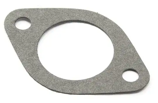

Also there probably should have been a gasket for the thermostat housing. Very small amount of silicone sealant was used instead of it before, you could see pieces of the old silicone instant gasket on the old thermostat. I went the same way, but now am in doubt. I don't assume this missing gasket could somehow create a way for the coolant around thermostat?
This was missing

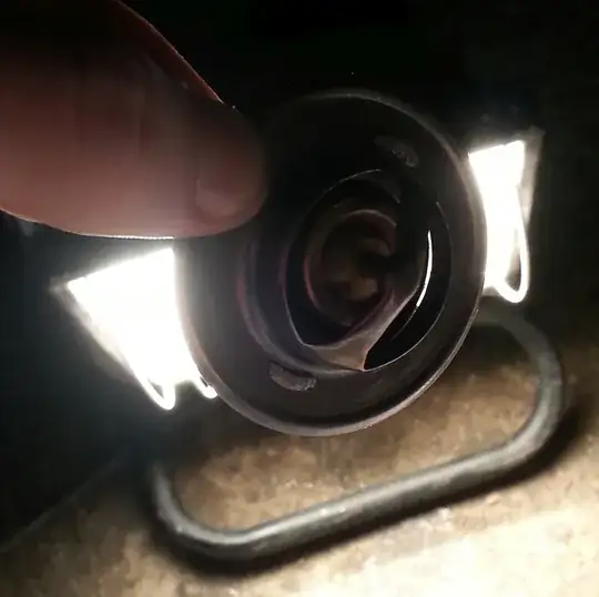

Put the (unbelievably hard to buy) gasket in, nothing has changed. I also noticed that the new thermostat has very slight gaps even when closed (seems larger in the image than actually is). It seems that they are a result of manufacturing imperfections, must be a poor quality part. I wouldn't believe that these would be sufficient to keep the engine temperature down below 70 °C by far, though. I am out of ideas here.
Slight gaps in the closed thermostat

Occasionally the electrical fan turns on, which is strange behavior considering the operating temperature is far from being reached. I doubt this is the cause, but it certainly does not help. Since the radiator warms up slightly before it should I'm thinking of covering it up to see if without proper airflow the car will reach higher temperatures. The only thing besides the thermostat supposed to be holding back the coolant is the thermostat housing, so it is my next suspect. Didn't notice anything unusual the last two times I took it off, but I'm really out of ideas here.

That thermostat gasket is essential in preventing the bypassing of flow. In the absence of it, I would not be surprised to see the behavior which you've observed.
